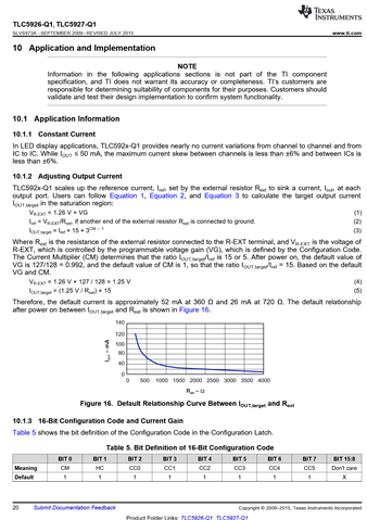

TLC5926-Q1: Value of output current in chapter 10.1.2
Part Number: TLC5926-Q1
In the datasheet of TLC5926-Q1 chapter 10.1.2 (Adjusting Output Current) is a calculation for the Output-Current (5). e.g. 26 mA at 720 Ohm. In Figure 16 the output current at 720 Ohm is approximately 40 mA. What value is currect, 26 mA or 40 mA?
