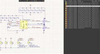

Hi
I downloaded the UCC27282DRCR spice module through the web site  to simulate the driver in Altium 22
files UCC27282_Unencypted_PSpice_Model and UCC27282
I am getting an error on the simulation
can you send my an update lib file to the component that you verified that is working on altium ?
Regrades

    The two spice file in the web site failed to run on the altium.
    Can you please verify if i am simulating wrong the component by running the file in altium at TI .
  • Hello Yoni,
    I looked, and we are not set up to run the spice simulations in the Altium tool. It looks like there is some error relating to C28 which is the cap on the HB to HS pin I believe. can you see if the adding some high resistance from HS to ground will address the error message?
