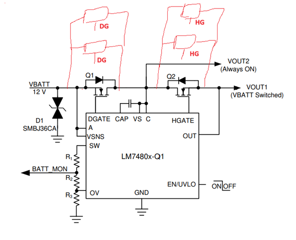

I want to know if a "single" LM7480-Q1 ideal diode controller can control multiple back to back MOSFETS (parallel sets for increased current capacity)? Thanks.
Hi Arif,
Yes LM7480-Q1 can do so.
Shiven Dhir
Hi Arif,
Parallel FETs can be driven as shown.
Here each rectangle represents a MOSFET.
DG stands for DGATE.
HG stands for HGATE.
