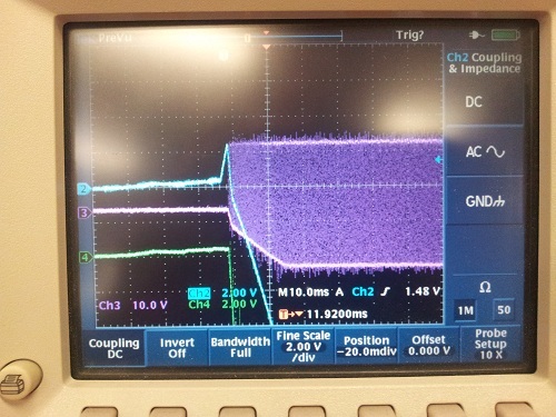

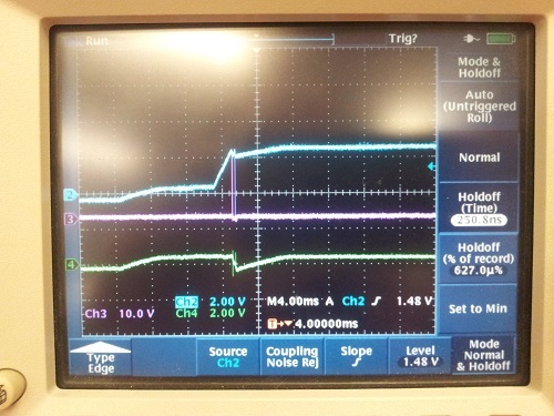

  • Blue Trace = Enable Pin
    Purple Trace = Switching Pin
    Green Trace = Output Voltage (during operation this should be -16volts)
    This is what it is doing when it is not starting properly
    This is what it is doing when it is starting correctly
  • There are possibly two issues that can be causing the problem.
    1) If you have dual rail loading on the +/- 16V output rails such as op amps or power amps or the like; Then it is possible for those loads to pull the -Vout line slightly positive and cause proper start-up of the negative rail to occasionally fail. We suggest placing a reverse biased schottky between ground and the -16V output rail to clamp this condition and allow proper start-up. (anode to -16V and cathode to ground) This is probably the problem, but also consider the following:
    2) Since we don't have access to your  schematic of the implementation of the enable of the negative rail let us direct you to AN-2027 (originally from NSC) which suggests several circuits to effectively drive the enable pin of a conventional buck used in the buck-boost inverting configuration.
    One possible configuration is to use the 18V input supervisory voltage divider on the positive switcher Enable input only. (UVLO control of +16V.) Then use the simple PNP level shifter shown in Figure 3 of AN-2027 as the enable control of the -16V inverting stage, driving this stages enable input from the +16V output rather than from a divider on +24Vin. There may be a need to adjust resistor values of figure 3. This configuration will only slightly delay the turn-on of the negative rail.

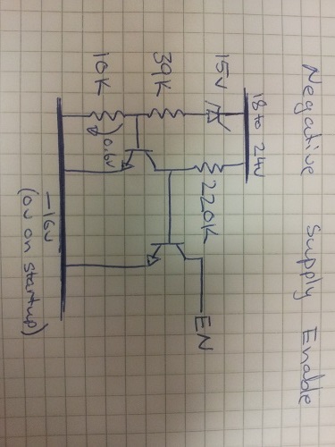

    I have decided to approach it from a different angle. Instead of driving the enable pin high when I want to turn the converter on, I have decided to pull the enable low until it is OK to turn on. This seems to work perfectly.
    Below is the circuit I have used. Threshold at room temperature is 17.95 volts.
