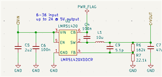

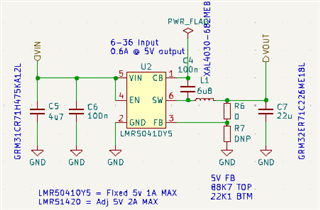

So we passed from from this design
that outputs 5V with this waveform
to this design (verified using TI Power Designer)

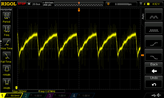

that output 5V (4.98V to be precise) with this waveform.
Could I get your suggestions on ways to reduce high-frequency spikes? What potential solutions should we consider?
