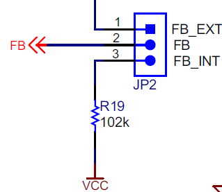

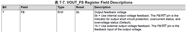

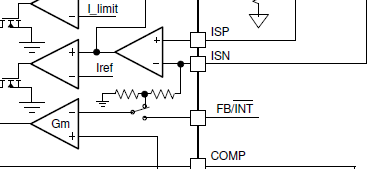

Does the FB/INT pin have an internal resistor, so if I want to use FB_INT, do I need to connect a resistor to this pin?
In the evaluation board documentation, 1 MΩ is connected.
”The JP2 jumper is for the external feedback or the internal feedback selection. By default, this jumper is set to
the FB_INT position.”
Do I need to connect 1MΩ to GND when using FB_INT?
Why?
