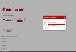

Firstly, there is a function in the tool, which automatically connects to the EVM when it gets attached. There is a bug, that is always connects to the first port (lowest in order). So when i connect the EVM it shows up as COM8, but the tool tries to connect to COM3, which is the lowest in order, which is also the default when loading up the tool. This bug not only makes this feature useless, but you also have to disconnect and reconnect the port, which takes longer than just connecting it.

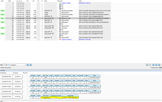

When configuring the source PDOs, there are two bugs. The first one is, that the configured current for PPS PDOs is sometimes wrong. For example, i configure a PPS PDO with 5-21V and 3A. When uploading it to the tool, and checking the sent PDOs with a POWER-Z KM003C, the maximum current shows up as 9.4A. Or when configuring it with 5A, it shows up as 11.4A in the analyzer. Its always the first PPS PDO, when using multiple PPS PDOs, the second one is always fine.

    1- The EVM Port can be selected in Options --> Serial Port Configuration in the GUI without having to disconnect and reconnect the port.
    Could you please provide the json file along with Power-Z logs of this behavior?

  • 1. The tool ignores the port selected in the settings, and always tries to connect to the lowest port when connecting a new port. For example when power cycling the evm, I disconnect the programming cable and then reconnect it. The tool then tries to connect to com3 insted of com8, which i selected in the options.
    2. Thanks for the hint, I must've overlooked that possibility. That works fine.
    3. Here are the config file and the POWER-Z logs:tps26750-wrong-pps-current.zip
    Interesting, I have not seen this issue. I have seen alternate COM ports get selected, but changing it in "Options->Serial Port Settings" always seems to work on my end.
    I did some testing, and saw that when I set up the TPS26750EVM and got it connected, disconnecting it would trigger the GUI to go to the "Hardware Disconnected" state and on replug, the GUI attempts to connect to the incorrect COM port.
    I'm able to easily set the correct COM port by using the setting above, but it is a little confusing as it appears like the correct COM port was selected.
    This is a screen shot of the Serial Port Config menu after I have reconnected. You might think it is connected to COM4(TI) here, but it actually connects to COM7 for some reason. (I see the connection status message in the bottom connect to COM7). The only thing I was able to do at this point was select COM4(TI) in the Serial Port Config menu and hit "OK", and then I saw the connection status update to connect to COM4.
    Unfortunately this does seem like a bug, so I'll reach out to the team to see if it is possible address it in a future version of the GUI.
    I loaded your config to an EVM and replicated the test on my end. Do you have any other PPS sink devices or any other PD analyzers?
    I also saw the PowerZ displaying the 9.4-A on my end, but when I connected a TotalPhase PD analyzer in series, it reports a different PPS current than the one the PowerZ reports.
    I tested this with 3 different analyzers, and all reported 3-A, so this appears to be a PowerZ issue.

    Unfortunately i only have the POWER-Z analyzer, but I might find another PPS-Device to try, and then i'll let you know. Meanwhile i will forward this issue to POWER-Z, as it seems to be on their end, and not yours.
