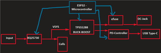

  • Hi Chris,
    Thank you for your response.
    In my design, I have separated the input and output, and I need to ensure PTM compliance. For this reason, I am not using the OTG feature, and the PD cannot be directly connected to the BQ25730 charge controller that I am using to charge my cells. Instead, I am generating the negotiated PDO using VSYS through a second buck-boost converter. The PD is configured to operate in a source-only mode.
    A second output is implemented to provide the customer with the option of delivering voltage/current through a DC jack. However, only one output can be active at a time. The entire system is managed by an ESP32 microcontroller.
    I selected the TPS65987D based on a recommendation from one of your colleagues. However, I see that the TPS25751 should be directly connected to the BQ charge controller if I want to source power higher than 5V, but it can only function as a DRP or sink.
    The issue I previously described is the following: I need to ensure that whenever a cable is connected, VSAFE5V is always delivered first—before any prior PDO or other output—until the negotiation process takes place.
    How would you suggest achieving this behavior?
    This a simple block-diagram of my design
    Ali

  • Hi Chris,
    Thank you for your response. sorry for the misunderstanding.
    I need my power bank to support an attached device either from the battery, from a connected input, or from both simultaneously. However, I am considering one of the solutions you suggested, such as disabling the "Type-C State Machine" in the Port Configuration register via I2C.
    I have few questions:
    1. Is it possible to configure the GPIOs of the TPS25751D to provide information about the negotiated PDO? This way, I could use this data to set the output through the MCU via I2C by adjusting the TPS55288’s output accordingly.
    2. Do you have any recommendations for a PD controller that supports up to 100W and can be used without a charge controller?
    3. In the attached document from TI, you can see that the TPS65987D is directly connected to the TPS55288, setting the output via I2C. I am looking for a similar configuration, but with an MCU acting as an intermediary between both ICs. Do you think it is possible to achieve the same configuration using the TPS25751D instead?

  • Hi Chris,
    Yes, that is an important clarification, I thought you had a BQ25730 on the input? Or is there both? I'm a little confused with the input stage now, could you clarify?
    My setup includes a Sink-only PD controller (TPS25730D) managing the input of the charge controller (BQ25730). The MCU adjusts the registers of the BQ25730, such as input voltage and current, based on the negotiated PDO (15V or 20V / 3A or 5A). After that, I use VSYS to generate the voltage for the PD source at the output.
    Please refer to my diagram for a complete overview of my design.

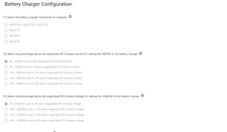

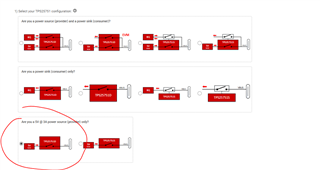

    This is very helpful, thank you! Do both PD controllers provide interrupt features via GPIOs? Since this method is much easier and less complex than overwhelming the I²C bus.
    No, in fact, you should leave those empty and should not choose one of the configs that contain a BQ device. Choosing a BQ config and answering those questions will enable and configure the PD to send I2C messages on the I2Cc line to an expected BQ device, programming config and functional registers during run time. If you are not using a BQ charge controller in this setup, this could potentially add issues.
    so if i'm using the TPS25751D i should leave the questions empty like this:

  • Hi Ali
    Thanks for the updated block diagram, this makes more sense.
    Do realize that the TPS25730 is much more limited in configuration and ability that the TPS25751 or TPS65987. It is a sink only PD controller that is configured through resistive dividers. It should be a good choice for the port if it is power sink only and does not require too much configuration or complexity.
    No, you may need a slightly custom project for this.
    You can start with the 5-V only config for testing, but you would essentially need a source only config that does not support sinking on the HV path. Correct me if I'm wrong, but the TPS25751 is planned to be source only?
    When you select this config, the BQ settings will be grayed out.
    The end result of using the App Customization tool is to be able to generate a binary using the Export->Generate .... feature in the top right of the GUI. If the options are grayed out for generation, this indicates that the questionnaire has not been fully filled out.
    If the BQ questions are not grayed out and still configurable, this means you are still using a config that will send the BQ I2C messages. To avoid this, select a configuration from q1 that does not have a BQ device in the diagram.
