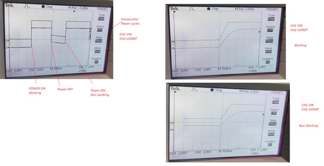

LM76005-Q1: Delay between two power ON cycle
Part Number: LM76005-Q1
Other Parts Discussed in Thread: LM76005
LM76005-Q1_Power_April_24th_2023.pdf
Hi Sir,
Our design is in production phase. We are facing a critical issue during the testing. We need your support.
PFA power supply design. 12V input to 5V output.
Issue we have observed is that between two consecutive power ON/OFF cycle with lesser duration the board does not work.
Channel 1 is 5V output from regulator. If more time is provided between two power ON/OFF cycle the board works.
