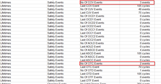

    It is difficult to determine a root cause without a log file representing the issue, however within the .gg file the Lifetime Safety Events track which protections have been triggered. If charge is being disabled, then it is most likely a protection being triggered that would open the charge FET. Based on the .gg file, the protections that have triggered that would disable the charge FET can be seen below:
    Producing the failure again and seeing which one of these increases would show which protection is being triggered at this time.
