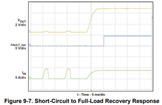

  • I was considering easier ways to go about this.  Why not skip the auto-retry circuit entirely?  The circuit is designed to retry automatically so long as EN signal is set to the enabled state.  See datasheet figure 9-7 for an example.  Would that suit your needs?

    * When we implement Cretry(For example, 0.22uF which is shown in datasheet), do you also think that we can observe this unstable retry cycle ?
    By the way, I could not find "figure 9-7" which you described in datasheet. Which figure did you point ?
    With Cretry, the re-enable is delayed based on RC time constant from VIN to EN to GND, so it will be stable.
    Here is figure 9-7.  EN is held in the enabled state for the entire capture.
