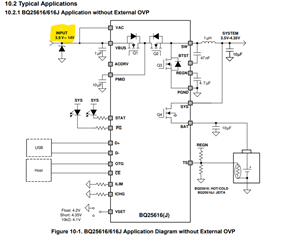

BQ25616: Device does not output anything when VBus is connected but gives a power when BAT is connected
Part Number: BQ25616
I have a one cell battery charger using BQ25616 which is connected to some load. The device accepts 12v input with Ilim set to 2.5A through Vbus to charge the battery and power the rest of the system. However, when I do connect the input 12v, I get now output and the PG and PMID pins indicate no voltage when I test with an oscilloscope. However, when I remove Vbus input and replace with a battery connected to BAT pin, I do get an output. Is the device fried or is there anyway to salvage this. I have provided a reference schematic.
