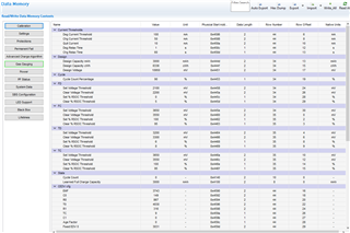

I have set up the BQ4050EVM and BQ25700A EVM boards in the following manner:

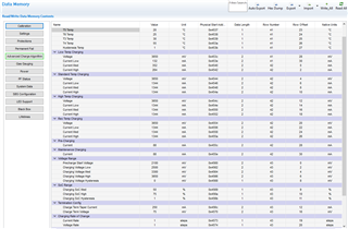

I have configured the BQ4050 parameters according to my battery specifications and carried out voltage and temperature calibrations. I have not performed the CEDV calibration since fuel gauge accuracy over temperature is not a priority for me at the moment.
The batteries I am using are currently discharged, and I am trying to charge them using this setup, and then discharge, to get the fixed EDV coefficients. There is no load connected to the VSYS pin on the BQ25700EVM.

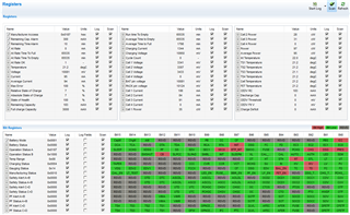

When reading the ChargeCurrent register from the BQ25700EVM using BQStudio, I see a charging current of 1344 mA. However, when measuring the current using an ammeter placed between VBAT (battery system) and the fuel gauge, I only observe 89 mA.
Why am I not seeing the expected 1344 mA charging current? Am I missing any configuration settings?

    Current Calibration has not been done, however there is not much deviation in current reported by the BQ4050 as observed on the BQStudio (In the Register Section)
