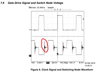

UCC28250: Switch Node Pulse Ringing – How to rectify it.

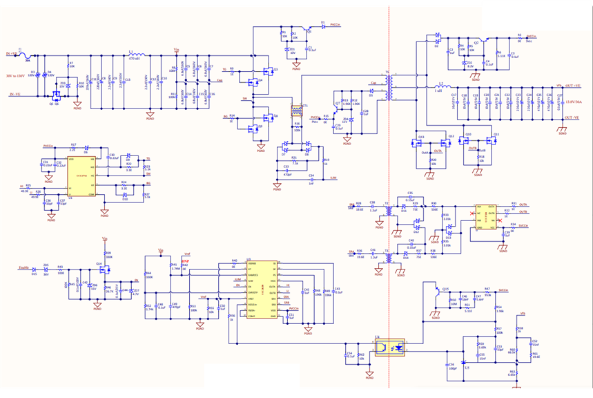

INPUT: 30 to 130V DC
OUTPUT: 13.8V / 30A
Reference Design: UCC28250EVM-501

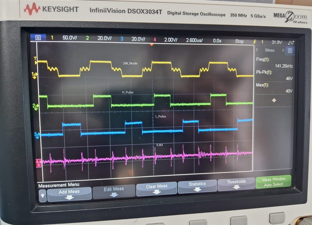

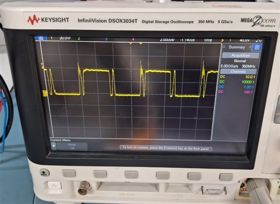

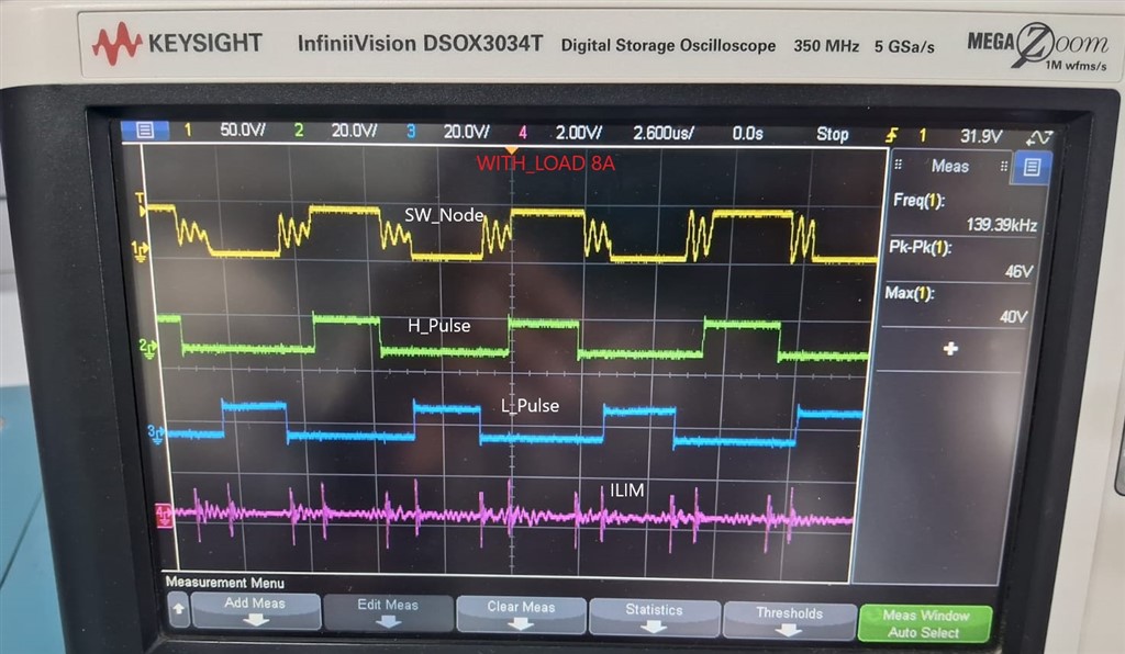

We have developed our own PCB based on the required form factor and have started testing. It has been working fine under no-load conditions. However, when the load was increased, the transformer saturated at 8A. (Please refer to the attached waveform.)
At 4A load:
At 8A load:

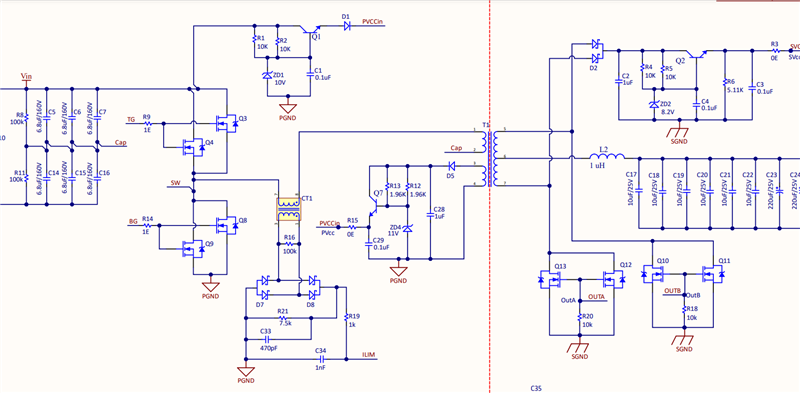

POWER CIRCUIT:
Please assist me to resolving this issue and I would appreciate any additional insights to help fix it. thank you...
