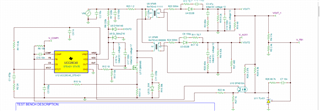

I want to stimulate SMPS circuit on LtSpice and TINA TI but facing some issues.
1. On LTSpice, the IC UCC28C40 is not working even after providing the biasing voltage. I have enclosed the same.

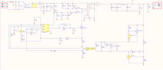

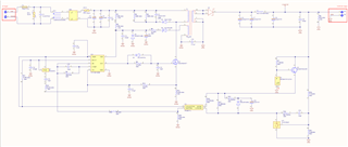

2. On Tina TI the stimulation results are very different from the desired outcome i.e., the aux will not able to generate any voltage. I have enclosed the same.
Not only this if I remove the aux and use only primary and secondary winding only the circuit is operating partially.

We do not support LTSpice

Please provide your TINA TI simulation file.
MINI_electro in TINA TI _with_new_transformer.TSC
I have attached the TINA TI stimulation file for the reference.
I created a new circuit based on your circuit and a workable circuit. Attached. It works normal. You can modify the attached circuit to your need one step at a time to find which step the circuit shows not working. Then find out why.
Please provide your simulation file that worked before changes, and also describe what changes you did the the file became not working.
