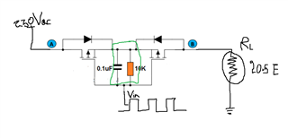

We are designing a Bipolar switch using the TI MOSFET for one of the product enhancements. We have seen a reference design in Cybernet and need to understand the impact of the resistor and capacitor in the circuit below. We are planning to keep the similar circuit as below
  • Hello Murugavel,
    Thanks for your interest in TI FETs. The resistor from gate-to-source of the FET appears to be a pull down to ensure VGS ≈ 0V if the signal driving the gate is left floating. The capacitor from gate-to-source slows down switching of the FET. For this application, you will need a higher voltage FET as the peak of 230VAC is 325V. I would consider using a 400V FET for this application. Unfortunately, TI N-channel FETs only go to 100V max. We do not have any FETs with higher breakdown voltage. Please let me know if you have any questions.
