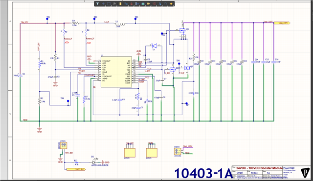

  • Hi yes here is my schematic to start off:
    Input voltage range is supposed to be 21V to 27V
    output voltage is supposed to be 100V
    Max current is supposed to be 3A
    I found my low side FET was failing and I believe it was not rated for the power I wat switching it with, so I switched to a higher power FET and it did not break.
    After added the higher power low side fet I was getting 99.7V at the output. I then loaded the booter with 66Ohms of resistance and the voltage dropped to 60V at the output. Not sure why this is happening. My new question is why is this happening?

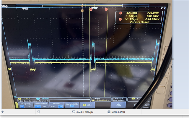

    Here are my switching output waveforms. They are quite noisy:
  • Hi Joseph,
    Thanks for all this data.
    An output voltage of 100V is very close to the abs max limits of the LM5122 device.
    The SW pin is rated for 105V, meaning a 10% overshoot on the switch note could be enough to break the IC.
    As you already commented yourself, the MOSFETs need to support the same voltage levels.
    For confirmation, you can measure the Vgs voltage at the low side FET during operation to check if the peak voltage goes above 105V.
    To work around this limitation, it might be required to use external drivers with higher voltage ratings in combination with the LM5122 device.
    Niklas
