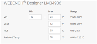

    We have implemented all the hardware modification shared previously, also now there is update in current requirement.
    Can you kindly confirm whether the design is compatible?
    New requirements:
    Input Voltage – 12V to 24V
    Input Current – 28A @ 24V & 56A @ 12V
    Required Output Voltage 12V
    Required Output Current – 24A (Typ) & 48A (Max - only in certain load condition).
    Please find the design calculation sheet - LM5176 Buck-Boost Quickstart Tool Calculations R01.xlsm
    Note: As per the calculation sheet we have considered the efficiency to be 85%.
    Thankyou.
    Nagendra Prasad
  • Hi Nagendra,
    as you see from the calculation sheet the recommended sense resistor is 1.7mOhm while you selected 3mOhm. So controller might detect overcurrent already to early.
    I am also concerned about the losses. This show already losses of > 10 Watt for higher currents which would be a temp increase of 200 Degree.
    For lower input voltages even more.
    Same for the inductor loss.
    For that output power level you either would need active cooling or a multiphase design.
     Stefan
  • Hi Stefan,
    This 48A current is not continuous current, It will react this stage only for couple of seconds(<1min).
    The steady current is only 24A, while checking in this condition the losses are minimal (around 2W), PFA -LM5176 Buck-Boost Quickstart Tool Calculations R02.xlsm
    For thermal design, the IC and its respective components (Inductor & Mosfet) are placed close to fan.
    Kindly suggest on this update.
    Thankyou.
    Nagendra Prasad
  • Hi Nagendra,
    thanks for this update.
    I suggest to check carefully on the real hardware.
     Stefan
