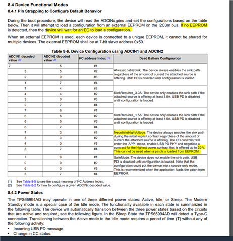

Looking at the datasheet I have difficulties understanding the configuration that is marked in yellow

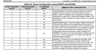

If we don't add any I2C EEPROM to the TPS65994, does it negotiate 20V in NegotiateHighVoltage mode?
Because 8.4.1 says the TPS is waiting for an EC to load a config in case no EEPROM is detected.

    That is correct that the PD controller would enable the sink path and be able to negotiate 20V PD without needing a config from an EEPROM or I2C.
    While in the default config, there is not a GPIO that is available. What you would do in this case is you would load a config to the PD controller over I2C through the SOC with a config that does have the correct settings.
    That is correct, it would do this until a config is loaded onto it from an EC. Please note that both ports would be in this mode and both ports would have the sink switch closed allowing for power to go into the system.
