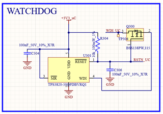

Dear experts,
I'm trying to work with the watchdog TPS3820-Q1 and a NXP microcontroller. The circuit is shown in the figure below:
The signal WDI_UC is a GPIO from the microcontroller and RSTN_UC is the microcontroller reset.
The problem is, the reset signal is permanently at low level. I guess, the watchdog is putting at low level the reset signal due tht WDI signal is not sending from the microcontroller because it is not programming yet. So, I cannot programming the microcontroller because the reset signal is at low level. Is there any way to program the microcontroller without disconnect WDI pin from the microcontroller.
Thanks in advance
  • Hi Luis,
    Thanks for your question.
    You can disable the watchdog. If the WDI pin detects that it is in a high-impedance state the TPS3820/3/4/8-xx-Q1 will generate its own WDI pulse to ensure that RESET does not assert.
    Hope this helps,
    Sila Atalar
