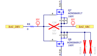

    We will be using 8S1P or 8S2P LFP battery packs for this. Also is it possible to share the design files for the BQ25750 EVM? It will help us replicate some of the power section as it is.

    When using an 8S battery, I recommend installing a 10Ω resistor in series with BATDRV and the BATFETs and a 10nF capacitor from BATDRV to BATSRC.
    You mean replace R9 on the EVM with 10Ohms and populate C36 with a 10nF cap? - I understand these will slow the turn on and off of BATFETs - why is this needed?
  • Ethan,
    In our testing today we figured out the reason for Resistor + Cap change. Without this the BATFETs were toggling probably because of the over current protection feature.

  • Hello Deepakji,
    1. Ideal diode mode works best when only using 1 FET. Are you using 1 or 2 FETs for ideal diode mode?

  • . Ideal diode mode works best when only using 1 FET. Are you using 1 or 2 FET
    Right now we are using the EVM, so the FETs on the EVM are as it is.

  • Hello Deepakji,
    We recommend using 1 FET because it allows the IC to better control the FET.

  • Ethan
    1. So this would mean the EVM cannot work in ideal diode mode? Since it has two FETs.
    2. What changes need to be made to the EVM for the ideal diode mode to work? - which one of the two MOSFETs have to be removed for this to work?
    3. Also what other function / feature is impacted with this change?
    We are evaluating this for a high volume application and any major or minor issues are critical for us, to ensure we don't end up getting this wrong and having many returns on our hands.
  • Hello Deepakji,
    1. Yes, it would not work well in ideal diode mode.
    2. You would need to remove Q8 and short R1004 and R1005.
    3. If Q8 is shorted across, this would allow current to conduct from the battery to system through Q7's body diode.
