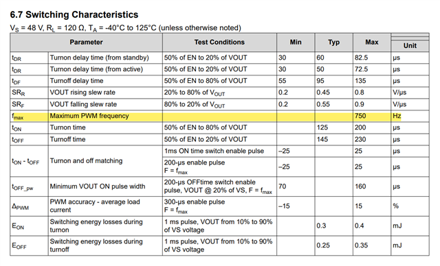

Can you help me find a highside switch that can work with the TMS570LS0432 that meets the following specifications?
It will output between 12-16V.
Rated 2.5A max. can withstand 5A
PWM frequency can be adjusted between 100-250Hz.
Short circuit/open circuit/overcurrent protection and detection
Exit from the high side
High side current measurement (Min. 0.5% resolution)
The controller must be compatible with the PWM signal output level (3.3V/5V)
Automotive must comply with AEC-Q100 standard
It can be used as a solenoid driver
Compliant with Functional Safety Standards
It must be actively in production and have a relatively trouble-free production life and stocks
