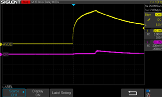

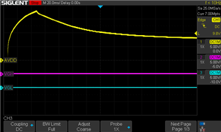

I'm prototyping a design to power a 7" LCD using the TPS65150 IC.
Immediately after VIN rises to 3.3V, the IC enters the fault condition due to a Buck Overvoltage (If I disable the fault protection, the Boost output reaches approximately 18V).
I tried a few different values for R5, but nothing changed between the attempts. What could be the cause of this unexpectedly high voltage? How can I fix it?
