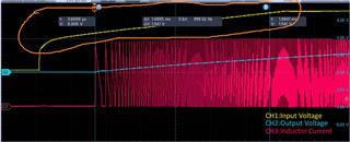

When the LMR51420YFDDCR is turned on with a light load (about 100mA), the inductor current goes into discontinuous mode.
The LMR51420YFDDCR is  FPWM version that maintains a constant frequency even at light loads.
I believe it will start up in PWM mode even at start up.
So why does it go into discontinuous mode after power is turned on, and then switch to PWM mode about 40ms later?
Vin: 24V, Vout:5V, Iout:0.1A

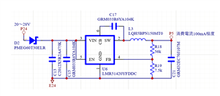

Schematic
0385.Schematic.pdf
Start up DCM then CCM
03_DCM to CCM.pdf
Power ON ~ 1ms
01_1ms.pdf
Power On ~5ms
02_5ms_1.pdf
Voltage and Current at DCM
The output voltage is 5.057V
Voltage and Current at DCM.pdf
Voltage and Current at CCM
The output voltage is 5.052V
Voltage and Current at CCM.pdf

    Something in the setup is triggering the over current blanking time.
    Is the customer testing the raw evm or did they modify to the schematic you sent?

    I understand that the reason why the LMR51420YF goes into discontinuous mode immediately after startup is because the overcurrent protection blanking time, tOCP_BLK (33 ms typical) is activated.Is this correct?

    The customer modified the EVM to check its characteristics.
    The components used are as shown in the connection diagram.

    Yeah charging the 100uF output capacitor at startup could be causing the hiccup to occur. Especially if they are using it in a system that can Input caps to power other devices downstream.

    In this case, the customer uses 100uF output capacitor, this causes hiccup operation at start up.

    It says that LMR51420 controls the average inductor current at the overcurrent protection blanking time, but that's not enough to understand that it operates in discontinuous current mode at startup.
    Please tell me more details.
    How does the overcurrent blanking function actually work?
    Looking at the operating waveforms, it does not seem to simply disable overcurrent protection temporarily.
    Why does it operate in discontinuous current mode at startup when the output capacitor is 100 μF?

    Does the customer have a way to enable EN independently from VIN? I believe the answer may be that VIN ramp is strange causing OCP mode.
    If it still does it then likely the high COUT is causing the OCP to trigger. If that's the case, the only way to have the FPWM after softstart that would be to use a lower COUT value.
