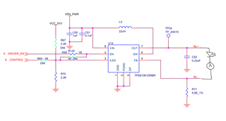

Hi Team,
Good day!
I am facing issues with setting the current limit for the design. As my understanding from the datasheet, we have pulled the ILED to GND and that should make the Vfb as 500mV.
From there, Rs=500mV/ I gives the resistance Rs.
In my design, we required the current limit to be set to 90mA (backlight LED with Vf=5.4(typ)), and hence chose 5.6Ohm resistance for Rs.
When I connected an Ammeter in series to the LED, I can see around 140mA of current.
Kindly support on this soon. Thanks.
