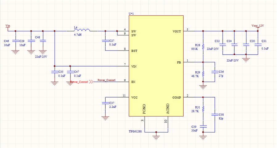

Hi Team,
My customer found the output voltage is not 0V while TPS61288 disabled(EN=0)
The Vin=5.28V and Vout=12V.
While EN=1, the Vout=12.5V, but while EN=0, the output still had around 4.9V
Please help to check the design and input your suggestions.
Thanks.
  • Hello Peter,
    In any boost converter, there is a diode from the input to the output. In a non-synchronous converter this is really a diode, in a synchronous converter, this is the backgate diode of the high-side FET. This means that you will see the input voltage minus a diode drop on the output in a synchronous boost converter.
    If you need the output disconnected from the input, please have a look for boost converters with load disconnect, see here: AC/DC & DC/DC converters (integrated FET) product selection | TI.com
