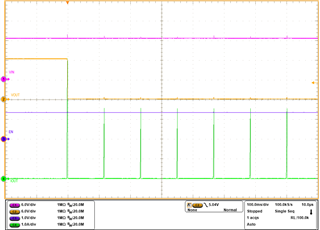

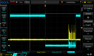

I have the circuit in two assembly variants. Both are not following the 100ms retry frequency. The output is shorted constantly. I see retry spikes every 4,5 seconds.
One variant shows 4,5 seconds retry:
This variant shows so seldom retry, that I have no picture.
What could be the routcause?
Simon

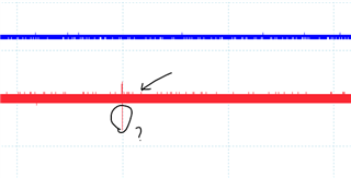

  • Hi Simon,
    I am assuming Blue trace is Vin and Red trace is current. To verify the retry mechanism, testing wakeup in short is correct decision.
    Why is the current going negative?
    What are these spikes and can you tell me there max value?
    Do you have any zoomed in waveform (y axis).
    Also I would recommend you to test with soft short scenario (short using resistor of small value like 0.2Ohms, etc)
    Arush
  • Hi Arush,
    thank you for your time.
    Red is the output voltage. Due to cable inductance it gets negative on current turn off.
    The short is applied via 1m long cable, connector and banana. So it is rather soft.
    Do you have any other idea why retry time is so high?
    Should I measure the current instead of voltage?
    Simon

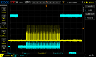

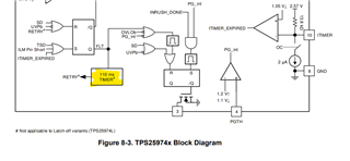

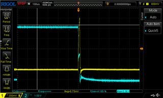

    I am Simon´s colleague. I took the case for the Fuse. The part number given at the top of the thread is wrong, the correct PN is: TPS25974ARPWR
    I have made some measuremnts and the device simply doesnt try again to conduct after an over-current event:
    Ch1(yellow): voltage over a shunt (output current)
    Ch2(blue): fuse output voltage
    from my understanding the device should try every 110ms to conduct, and once overcurrent detected, then it should stop again, and this process should go on, is this correct? If so, what could cause this delay / termination of retries?
    When using the TPS16630RGE fuse, it does something like this, every 2s or so:
    Ch1(yellow): voltage drop over a shunt (output current)
    I assume its because of the base 1.25s delay of the thermal regulation? The problem here becomes, that this fuse, even though it retries to conduct, becomes very hot. Will the device shut down in this case due to it´s thermal regulation?
    Thanks a lot for your time and help and have a nice day.
    Cheers,
    Vlad
  • I made a mistake with the part number. It is TPS25974. I will measure current today and come back to you.
    No issue. both devices should have shown similar behavior here.
  • Hi Vlad,
    Yes, that is correct. Once device hits thermal shutdown threshold, it will turn off. It will wait for temperature to drop by 10C and then will start this delay of 110ms. After this it will perform retry.
    From the waveform, it looks like the device is doing retry once and then not doing it afterwards.
    I have this waveform from some older testing. This is TPS2597 device. I did hot-short so initial current spike is higher and then afterwards each retry will be current limited and due to high power dissipation, retries will fail.
    Is it possible for you to share the test setup and steps you are following.
    What is the difference in test setup and steps followed when testing TPS1663 and TPS2597. Here the TPS1663 device looks like is doing retry.
    Arush

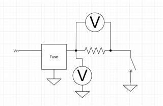

  • Hi Arush,
    Thanks for your quick reply.
    There is aboslutely no difference in the setup. This is how the setup looks:
    In my upper fotos, the yellow signal corresponds to the voltage measurement across the shunt and the second voltage measurement (ch2 or blue) simply for the output voltage. At the output / load there is no switch, I simply short the 2 banana connectors that I have connected to the second pin of the shunt and GND. So in this setup for both Fuses, the ICs behave differently. The TPS2597 doesnt seem to retry to conduct (according to the oscilloscope images), however after 10-20s the fuse resets and it conducts normally.
    The TPS1663 on the other hand, keeps trying and gets hot, as described before.
    FYI, for the tests, I do not hold the short circuit, I simply touch once to test the fuse and then leave open loop.
    Thanks for your time!

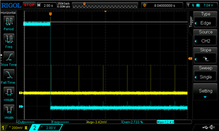

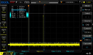

  • Hi Arush,
    I did as you suggested: En to external 2V, OVLO to GND and a SC yielded this:
    Holding the short and removing yields this:
    The setup remains the same:
    Ch1 (yellow) voltage drop across the shunt (0.1Ohm)
    Ch2 (blue) output voltage of the fuse
    For both tests 0.1 Ohm shunt was used. While keeping the short, the same result can be seen as by the TPS1663, the fuse retries, but just gets really hot. Is it safe to assume that the thermal protection will stop the device from trying until the temeprature is safe again?
    So the 2V at EN and OVLO to GND seems to do the trick. With this test you wanted to isolate the issue. What is your opinion on this, what do you think the issue is? Does the device see an overvoltage at input during a short and hence stops trying to conduct? If so why wouldnt it try at all, later, like 2 or 3s after the initial short, since the input voltage would have became stable again in this time, or am I missing something?
    Yes, this was repeated with 2 same TPS2597  Fuses, but I only tested 1 with this new configuration / test from you.
    Thanks for your time and cheers,
    Vlad
  • Hi Vlad,
    This looks good. We can see auto-retries.

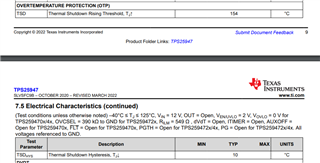

    Yes, Thermal protection will trigger when junction temperature reaches 154C (typical) and will wait for device to cool down by 10C i.e. 144C and then it will start the retry delay timer of 110ms. So during continuous TSD events, your average temperature of device will be very high. TSD prevents immediate damage to device but this high operating temperature is not allowed for the device. The good part here is, we don't expect device to operate like this during normal operation and we only expect this kind of behavior during some faulty state.
    I wanted to remove possibility of UVP or OVP hitting when doing the test hence I requested this setup. Most likely Vin was dropping to low value and hitting UVLO or UVP which resets the device. Then the device will perform startup. Honestly, I would expect the device to show retries even if this was the case. To further root cause this I would suggest capturing some waveform with older setup. Probing EN and OVLO pins might give us some insights.
