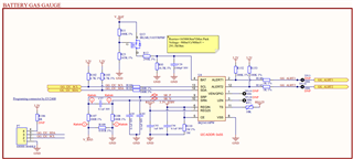

Hello.  I'm not sure if this question has been covered already.  We have a design in development that uses the bq34110 (the BQ34110PW specifically).  We've repeatedly tested this gas gauge and consistently run into the same issue.  I know it is for applications where the battery is only rarely discharged, but we wanted to test in all conditions.  We have performed complete discharge tests on multiple units, multiple times.  We know that at the beginning of the tests (battery full charged and BQ34110PW reporting correctly, battery full charged).  As we run down the battery the reported charge seems to be counted correctly.  The battery is spec'd at 4930mAh and the gas gauge reports ~4750mAh have passed through it during discharge.  However, on charging, we consistently see the BQ34110PW only counts ~3550mAh over a complete charge.  We can confirm that the battery was in fact completely discharged.  Why might this be?  We've seen it said we could perform multiple charge/discharge cycles for calibration, but this is unacceptable for a production line setting.  We can't have units go out that report funky values for several charge/discharge cycles.  Has anyone encountered this?  I am a EE.  I can provide our schematic (dragged into editor).  We followed the application notes.  I do not have much detail on the code, but if that is needed I can have our FW engineers provide that information.  Let me know what you can.

    Can you share a log file?
    Are these the only parameters you have changed?
    Diego
  • Yes, that is all the FW team gave me so it must be all they're setting.  I was surprised also because in the datasheet there are many more that give formulas and things to calculated the correct setting, implying they need to be set.  I think the FW guy might be confused because I asked him and he said those were 'learned' and updated themselves, but when I checked a box that had gone through several cycles they had not changed.  I recently talked to the company that made the battery and they said they may have suggestions for all the settings for this part.  Do you guys have an example setup that I could pass along to the FW guy so he can see what all he should be looking at in addition to the ones above?
  • Hello again.  Another question or two.  In my last reply I mentioned how the battery maker said they had recommended parameters for the BQ34110, but it turns out they were using the what they called the "BQ34100".  I'm looking into how similar those are to each other.  Could you shed any light on that?  When I search DigiKey or Google BQ34100 I only get hits for BQ34Z100.  I'm concerned now since they weren't actually using the same part and potentially didn't even give me the right PN for what they were using.
  • Hello again.  Could I get some feedback here?  I've gotten the FW team to look at this again and they're looking at the other parameters they need to set.  I've also gotten in touch with the manufacturer of the battery we're using to try and get all the physical parameter information from them that will help with the register setting and calibration.
