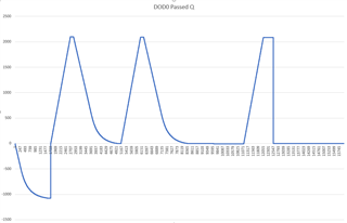

    Would it be possible to run the two charge/discharge cycles with the device programmed with the .srec post learning cycle with the Qmax Passed Q value logged? This would allow us to see the passed charge that the gauge is observing during the discharge, which is where the gauge will update the cycle count. This was taken on the golden image log as well.
    Anthony
  • Hi Anthony,
    The attachment contains the charge and discharge log for 2 cycles. All detailed data has been selected and recorded. The Qmax Passed Q value calculation is correct, but the cycle count has still not updated. Please check the attachment.
    Thanks!

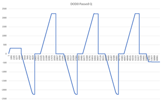

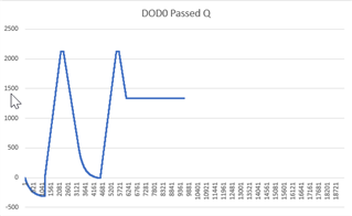

  • Hi Tom,
    Thank you for sending this log file, based on this file and the golden file, it seems like the passed charge accumulation is not resetting to 0 after each charge/discharge cycle. Would it be possible to run the same test with the Passed Charge logged with there being a relax period between each charge/discharge?
    2cycle test:
    golden:
    Anthony
