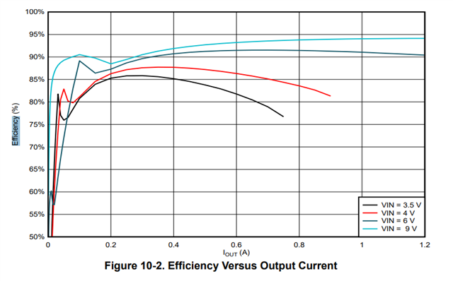

What is the best efficiency I should expect for LM5158 as a boost convertor from 3V to 60V and an output current of 30mA?
Hi Cezar,
Thanks for reaching out via e2e. With a Vin of 3V and a load of 30mA you can expect an efficiency around 85%. You can refer to the following graph.
