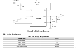

  • Hello Again!
    This screenshot is from the datasheet, it's very close to our configuration and the datasheet mentioned the output current is 50mA.
  • Hi Mohamed,
    What's the inductor used in your application? Or could you send me your schematic?
    For your screenshot from datasheet, the 50mA is the Iout in the example application, not the max Iout.
    And when Vin = 3.6V, Vout = 13V, L = 10μH, the max Iout should reach around 100mA.

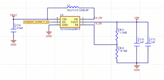

    Well, to be clear, the problem is when the Boost is not enabled ( display OFF)  our device works fine, but when we allow the Boost the voltage drops, and the sensors' data is bad with fluctuation and drops in signal level.
    Here is our design, the inductor is 10uH with a 450mA  current rating, and our display draws around 60mA.
  • Hi Mohamed,
    Sorry I'm confused about the saying above. Especially about that when the Boost is disabled, you device works fine. Could you explain in more details?
    I didn't see concerns on your schematic, except that the Isat of your used inductor is too small. Could you also send me the layout for review?
    Please do a quick experiment if available: use a 10μH inductor with Isat at least 1A. I think with this change higher Iout can be extracted and the Boost may work fine.
