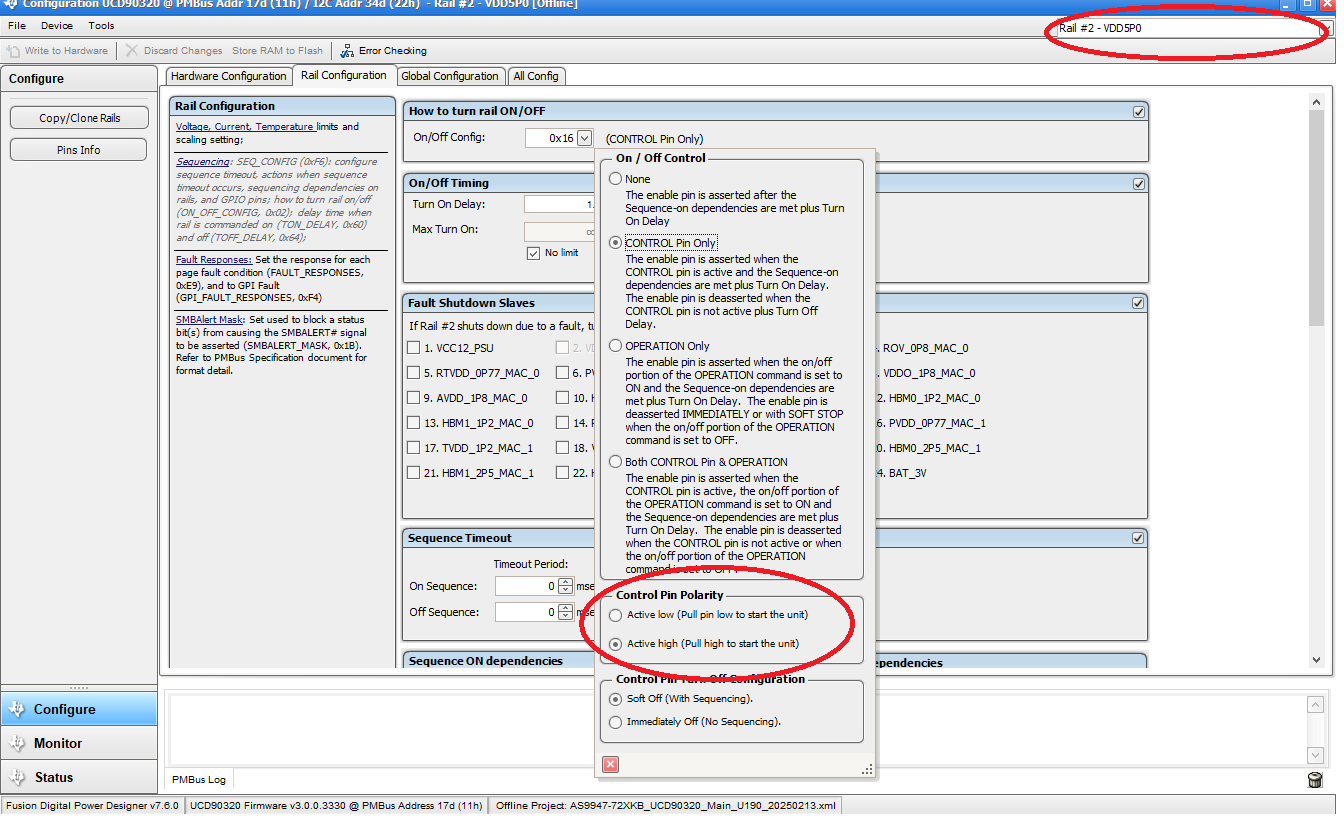

  • Hello again,
    on the UCD90320 datasheet there is very brief description of the use of the PMBUS_CNTRL line. Is this signal active high or low? I want to use the PMBUS_CNTRL signal like you have suggested to reset all the rails via the watchdog, but I want to make sure I drive the correct signal to the PMBUS_CNTRL line.
    Thanks again for your assistance,
    regards
    Ali
  • Hello
    You can select the polarity from GUI
    Yihe
