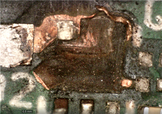

I am seeing a failure mode on the enable pin of the TPS22810 melting and the TPS22810 packaging melting during normal operation with Vin=12V. The datasheet specifically calls out that the enable can be driven by a 1.8V, 3.3V or 5V GPIO on page 15, but the recommended operating conditions for Ven Min/Max are 0-18V. In our system we tie the enable directly to Vin and Vin=8-15V. In the failure mode the system is running at 12V in normal steady state condition and the TPS22810 spontaneously fries. The steady state draw of the system is 250mA current. Can you verify that the enable pin can handle being shorted to the VIN with 12V-15V?
  • Thermal vias were not used underneath the IC. As the junction-to-ambient temperature is massively different between the DRV (currently using) and DBV packaging is there any data between thermal via and no thermal vias to estimate the thermal junction I might be reaching?

  • I see. Thank you for the info. Unfortunately, on these boards we are not able to recover them as the failure mode results in the IC disintegrating and melting through multiple layers of the circuit board directly under the IC. The boards after have a short between power input and ground due to the melting of the dielectrics.
  • Hi Dan,
    Understood. If you have any fresh boards remaining, can you check this. No need to power on the device. Just check this after soldering the device. Also can you share some photo of damaged device (while it is still on the board). Just send zoomed in board to prevent sharing full design.
     First thing I would say is can you check soldering and see if there are any shorts?. Also use multimeter diode mode to check diode drop from GND to all pins. We should have ESD structures which should provide some diode drop.
    Arush
  • On a functioning board there is a 500mV-700mV diode drop from ground to the other pins and no shorts to ground. The damaged IC can be seen on the left and with it removed and the debris pulled off the plane below that has been melted through and now is shorted to the power input. The failure is identical on two boards.
