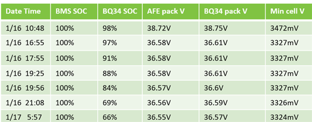

Specifically, we performed 12-hour rest tests at SOC 100%, 75%, and 20%. During the 100% rest test, we observed that the gauge's SOC drops rapidly.
SOC 100% rest behavior

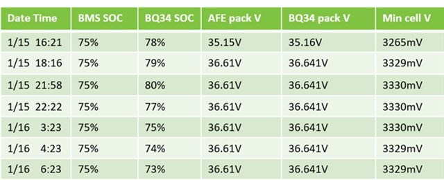

SOC 75% rest behavior

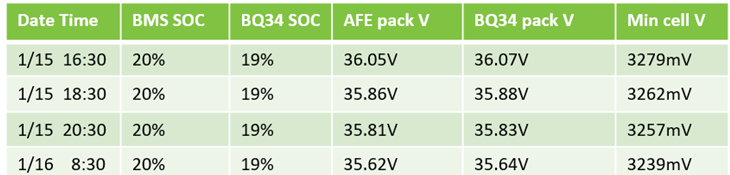

SOC 20% rest behavior
Among these three cases, the SOC drop at 100% rest seems abnormal. We conducted this 12-hour rest experiment three times with two different battery packs, and the results were consistent.
Afterward, when charging the battery, we found that only about 4% of the capacity was needed to reach full charge, indicating that the actual battery capacity did not drop as quickly as the gauge SOC suggested.
Attached are the gg file and the SOC 100% rest log. Could you help check if this is a configuration issue or if any adjustments are needed?
