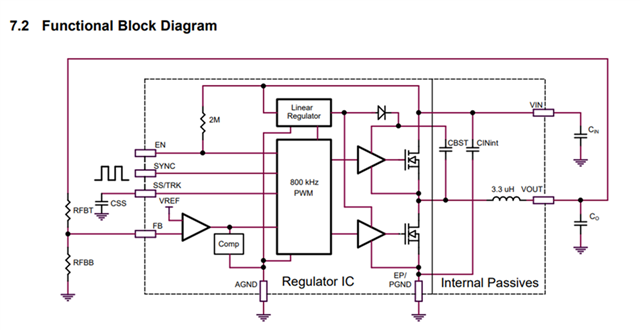

Thanks Andrew, we are actually seeing 6.5V. There is concern since this is above the ABS max rating (5.5V) for the part. Since the EN is disconnected on the PCB, the pull up is coming from inside the part. Is this a reliability concern?
As I look at the block diagram, there is a 2Megohm resistor shown pulling the EN pin to Vin. There is also mention of a 21uA current source that kicks in after the device is enabled.

The 6.5V probably has to do with what VIN is being applied, and the current through that 2M resistor. This device doesn't support any modes where EN is floating and will have erratic behavior depending on the operating conditions. Likely the 6.5V isn't supplying much current (because of the 2M), but I wouldn't have this device operating with EN floating for long periods of time.

Paragraph 8.2.2.2 of the datasheet states “the Enable input may be left open circuit and the internal resistor will always enable the module”
So if this is true, how do we explain the ABS max violation (5.5V max but we measure 6.5V)?

If you are concerned about this for your application (ie you plan to operate at VIN = 36V), then you can add a zener clamp to EN to a safer value.

We state at the start of 8.2.2.2 that the pin may be left open if EN is not needed without any limitation on the input voltage, does this only apply for Vin < 5.5V since there is a pull-up (2MegOhm) to Vin?
Is there some Vin voltage limit where the EN pin can be left open?

For your application it sounds better if if there was a resistor divider rather than letting the 2 MOhm pull-up do the work.

Thanks Andrew but this "open EN pin" design has already been shipped in multiple products and is in the field. We need an assessment of the reliability of this configuration.

There's a zener that clamps EN to 6.5V. Externally the part is limited to 5.5V. This is because there's a current limit on how much the Zener can take, and an external power supply can supply unlimited current.
You should be ok to leave them floating.
