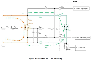

Is there anyone who successfully implemented external balancing Mosfets?
There are only 2 occasions where this topic was discussed 3 and 4 years ago but seems no real solution succeeded.
I am afraid that the the internal Mosfets are going to be extremely hot, and even the device cuts balancing from time to time, there would be 105 degrees on its body all the time.

    I am not aware of anyone who has explicitly used external balancing Mosfets. The internal Mosfets do get hot, but the device will function normally with up to 240 mA of balancing current at an ambient temperature of 75 degrees C (As per section 9.3.3.1.3 of the datasheet). If you require a specific temperature limit there are built in temperature sensors that will pause balancing when the temperature goes above the user-set threshold.

    I've read the datasheet - as low you set your desired temperature, as longer the device will need to cool down ... practically it will cool down 90% of the time ... unfortunately we have no such time to wait for.
    Temperatures of 105 (or even 75 degreees) are not recommended when designing high reliability circuits. Our company does that and this is the reason I am looking for a real solution. I have one - working well (using TI competitor's xxx681x device), so maybe I will need to stuck with it even our safety approval will be more difficult using their documentation.
