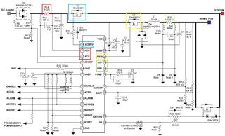

Hello I have a question.
Please Check the below
1) Cut off U2 (FET) on ACDRV side at input over current according to R14 (CS resister) value designed on ACN / ACP line
2) Cut off U3 (FET) on PWM side at output over current according to R20 (CS resister) value designed on SRN / SRP line
If the above is correct, please check if it is Pin Open or GND processing when ACN/ACCP Pin is not used.
