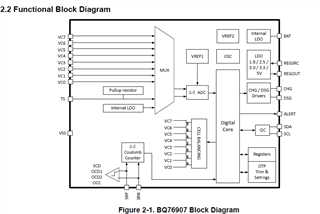

Hi TI Support Team,
Can we pull down the REGOUT pin voltage to 0V faster after entering shutdown mode for BQ76907.
We saw the REGOUT pin voltage dropping slowing using the BQ76907 EVM.
