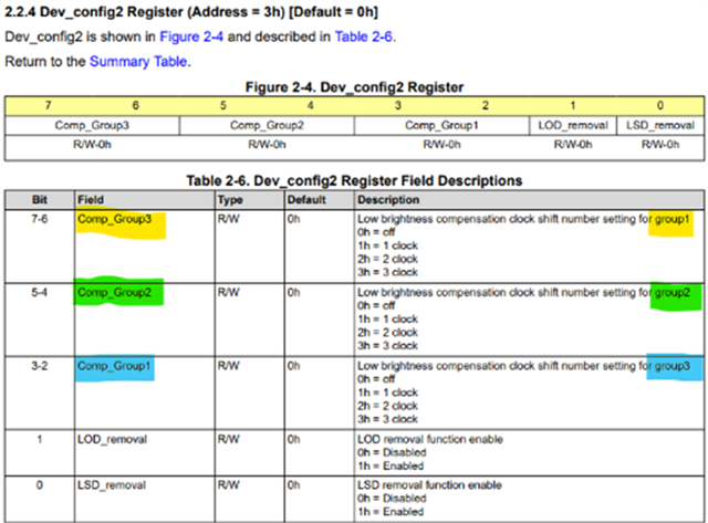

  • 2.2.4 Dev_config2 Register (Address = 3h) [Default = 0h], parameter field & description shows different group. Required clarification on which parameter is for which group.

    2. Please refer below description in datasheet.
