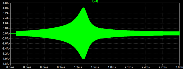

I'm designing a ~2..3W supply with UCC25800: Vin=24v transformer turns ratio 1:1, fsw 500kHz, voltage doubler rectifier. I wonder how much output capacitance is permitted so that the mosfets won't get too hot during soft start? Is it enough to stay below maximum OCP2, ie. below 5A peak? I suppose TSD is not fast enough to react within soft start period? For instance, with 30uF output capacitance, according to simulation, SW pin current looks like this during SS:
BR,
Olli
