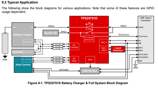

  • The TPS25751 doesn't provide the USB SuperSpeed (SS) Mux for routing the high speed Tx/Rx pairs which is why I need HD3SS3220. Typically the SS mux determines which tx/rx pair to route from connector to host/device based on the which CC line is pulled down.
    My understanding is that the TPS25751 gets the CC lines from the connector, handles the PD negotiation, and uses its GPIO outputs to drive CC inputs of SS mux like shown here:

    I don't know the HD3SS3220 well, but when I took a brief look I didn't see any obvious input GPIOs for mux control. It looks like the part was intended to be standalone(no pd controller) with integrated CC line control. The couple GPIs I saw were for configuring the CC controller, whether it is port Data role, Current advertised, or enable pins. There did not seem to be anything that specifically controller the SSTX muxing.
    This is potentially correct, the TPS25751 does have CC line connections, handles the PD negotiation, and can use GPIO outputs to drive GPIs of a SS mux.
    We would never drive the CC lines (CC inputs) of another IC from our GPIOs. Instead we typically have GPIOs for things like Plug_Detect and Cable_orientation that would drive respective inputs on the SS mux.
    The issue with the HD3223220 is that it has it's own CC lines and seems to handle the muxing internally.
    Hope this helps, but let us know if you need further clarification.
