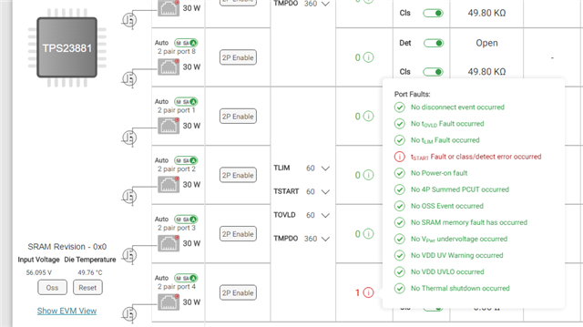

  • the TPS23881 is detecting that the channel is connected, R is valid, it sees that the board is requesting class 8, but reports the following error via the GUI:
  • This seems very confusing to me as it seems to be fully detecting the POE, but failing to actually do the last step and apply the load to the port.

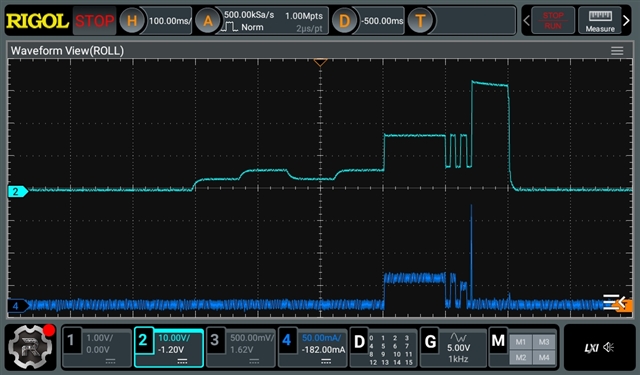

  • Here is my scope image:
CH2 = voltage 10v/div, CH4 = current using 25Mhz AC/DC probe in 50ma/div
To my untrained eye this looks good or like the first part of the communication is working perfectly, but for some reason the voltage does not go up to the ~50V instead it goes up to like 33V. Which my understanding is basically telling the POE PD to disconnect rather than connect.

    1. BOOST-PSEMTHR8-097 has 8 x 2-pairs port. This can only go up to Class-4, not Class-8. BOOST-PSEMTHR8-097 at Class-8 may run into power demotion mode (request Class-8, assign Class-4)
    Class-8 needs a 4-pairs port, and you may need a BOOST-PSEMTHR-007 with 4-paris port.
    2. If you are running open load test, make sure you have a 1.5kOhm, 1W rated resistor between AMPS_CTL to VSS for maintaining power signature.
    3. The VDD-VSS voltage is strange to me. It should be closed to the PSE board's input voltage. Can you measure both VDD-VSS and RTN-VSS at the same screen?
    Diang
  • Hi Diang,
    So your comment got me sparked on a whole bunch of diagnostics. The comment about the voltage looking strange was what I locked on to. I also hooked up the scope to the VDD-VSS of the TPS2373-4EVM-758 and totally agreed with your comment about it looking strange... well the problem was not with any of the TI parts :). It was my "optimization" of the layout of the OnSemi FDMQ8205A full bridges that I was using. They are VERY serious about the gate pins being routed in the strange way where the INPUT 2 = G1 & G2 and the INPUT 1 = G3 & G4. I had flipped them so that I did not need to use vias on my PCB. Which could have explained the weird voltages. I cut up a few traces and installed a few bodge wires and it works now. Thanks so much for the comment about the voltages and that was the key that unstuck by brain!
