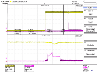

5.2V is input to the TPS7A2050PDBVR to generate 5V.
The current value was measured when an inrush current occurred in the circuit to which it was supplied.
(CH1: Input voltage CH3: Output current)
According to the datasheet, the current limit is set at approximately 360-700mA,
but it appears that about 1.2A flows at the moment of inrush and then the limit is set.
Is this correct behavior?
Also, if it is correct, is this inrush current value acceptable for the device?
