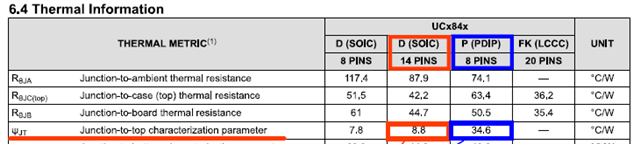

Hi team,
As you can see, there is a big gap of psi_JT betwen SOIC and PDIP as below. Could you tell the reason?
Noriyuki Takahashi

Hong,
Thanks, but they want understand the techinical reason why psi_JT value of SOIC is largely different with PDIP.
Could you tell the reason in term of this?
Noriyuki Takahashi

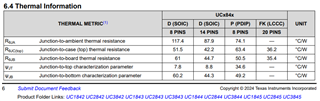

The latest datasheet does not have that large difference so it is likely the old datasheet might have that as an error. Please use the latest datasheet to your reference.
