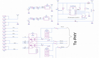

I am using TPS2375 for PoE in a PD. Below is the related schematic:
PD class is set to Class 0.

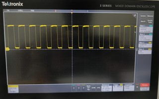

At first I had 0E in place of 2.2uH then I was seeing below output across 100uF capacitor on the output of TPS2375:
After I replaced the 0E with 2.2uF I'm getting below output:
What am I missing here? What could be the reason I'm getting such an output?

  • Hi Abhinav,
    Could you try to add a load between POE_OUT+ and DGND? PSE needs a minimum maintain power signature current (>14mA) drawing from PD or PSE may turn off the PD port. A  ~3kOhm resistor with power rating > 3W could be considered.

  • HI Diang,
    Tried adding a load of 3.3K but the output hasn't changed yet.
    I'm still getting 0-52V switching output as shown in the previously attached images.

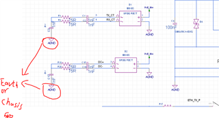

    I did not see other issues on the schematic. One concern is the Bob-Smith terminal ground is normally not short with VSS, it normally is earth/chassis/output GND/floating depends on applications.  But it should not be related to your issue

  • Hi Diang,
    Your point is right, I had tried increasing the load after ~3.3K load and the voltage was stable this time. However, I had chosen 50mA load, now I will try reducing it to find out the optimum value.

  • Hi Abhinav,
    Thanks for your reply.
    The minimum DC current should > 14mA theoretically.  In this case 50V / 3.3k = 15.2mA should meet. But maybe there are some minor factors, like voltage is smaller than 50V or current sense resistor error. Using a 2.5k resistor may be enough.
    The PSE will check if the PD is still actively drawing power or the PSE will turn off the port. In most of cases you do not need to add a dummy load. Normally during start up, the PD needs to switch from open-load status to load status within 300ms to avoid PSE turning off.
