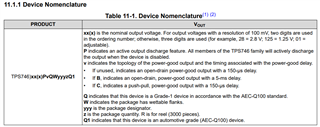

The TPS746-Q1 has many options, but the datasheet doesn't inform how to order the correct part number.
For example: TPS74650PQWDRBRQ1
I suppose that is the 5V fixed output due to the 50 after the TPS764.
Is a VSON due to the DRB
Is automotive due to the Q1
But I have no clue if it is a push-pull output or open collector output for PGOOD.
So could you add in the datasheet the clear description where in the part number we can find the voltage or if it is adjustable and the output type.
In particular I want to select the part number with the following characteristics:
  • Fixed output at 5V
  • VSON 8pins
  • PG open collector
  • Automotive
Note: Selection tables on internet and datasheet don't allow to find the correct part number. Here the links:
