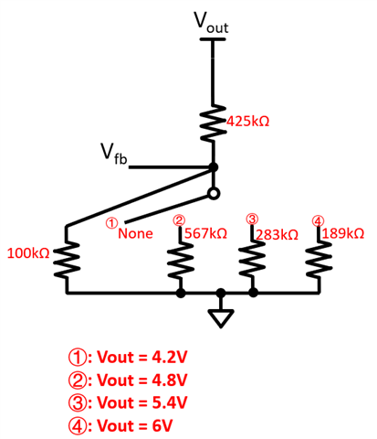

お客様各位、TPS61379-Q1の出力電圧をロータリースイッチで4パターン程度に設定したいのですが。 上の抵抗器を固定し、下の抵抗器だけを変えて、6V、5.4V、4.8V、4.2Vの電圧に設定したいと思います。 抵抗の計算方法を教えてください。 これを行うときに注意すべきことは何ですか? FBとグランドの間にコンデンサを挿入する必要がありますか? コンデンサの大きさはどれくらいですか? その他、気をつけるべき点はありますか? よろしくお願いいたします。
  • Dear Customer, I would like to set the output voltage of the TPS61379-Q1 to about 4 patterns using a rotary switch. I would like to fix the upper resistor and change only the lower resistor to set the following voltages: 6V, 5.4V, 4.8V, 4.2V. Please tell me how to calculate the resistors. What should I pay attention to when doing this? Should I insert a capacitor between FB and ground? How large a capacitor would be? Are there any other points I should be careful of? Thank you in advance.
    You may refer to the datasheet for the feedback resistor calculation. Following is an example for reference.
    I'm not sure that while switching between different tap positions of the rotary switch, whether there will be a short duration that the bottom resistor is open? If so then during this short duration, the TPS61379 can't maintain the Vout, especially if the load is heavy. So in the above reference design, the 100kΩ is always connected. The Vout can at least maintain 4.2V during the short time when the rotary switch is switching between different tap positions.
    I think it's no need.
    I think you may pay attention to the possible Vout drop while the rotary switch is switching between different tap positions and check whether it's OK in you application.
