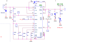

  • Hello Anoop,
    Is there negative voltage induced on the device?
    Can you send me your GaN RF schematic which is connected to TPS2663 output?
    If you want, we can have this discussion online and further debug step.
    Amrit
  • Hi Amrit,
    Is there negative voltage induced on the device? ->I haven't tested it
    The GaN connected to the eFuse is the GTRB384608FC
    We shorted the eFuse output with a 4A resistive load during testing, and it successfully provided protection.
  • Hi Amrit,
    Is there negative voltage induced on the device? ->I haven't tested it,but I will check
  • Hello Anoop,
    Thanks for sharing the block diagram.
    Can you help me understand the test case in detail. Do you start-up issue? How do you come to conclusion that eFuse is damaged?

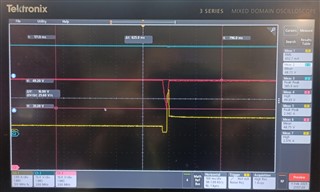

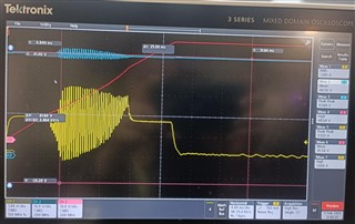

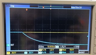

  • Hellow Amrit,
    Please check the captures below
    Experimenting with the MAIN PA eFuse: -> Monitored the input voltage along with the input current of the eFuse (Cdvdt= 0.022uF) on DSO.
    1) Efuse - ON Gate-> OFF.  (Drain capacitor 660uF)
    -> eFuse Input current
    Large blue circle -> eFuse Input voltage
    Red circle -> eFuse Output voltage
    2) TX ON  (E-fuse ON, GaN ON)
    Here the IDQ current is changed for Carrier ( varied +/- 800mA) a) IDQ current changed to -2.80
    3) PA - OFF(Gate off, Efuse Off)
    Large blue circle -> eFuse Output voltage -->>

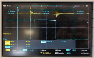

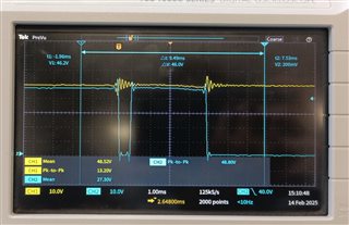

    Short circuit experiment Wtih Resistive load
    4)
    Monitoring the eFuse I/P and FLT pin of eFuse:
    * To check the fluctuations at the eFuse input and the eFuse FLT pin when short circuits at the output side with load 2A.(resistive load)
    5)
    * To check the fluctuations at the eFuse input and the eFuse FLT pin when short circuits at the output side with load 4A.(resistive load)

  • Hello Anoop,
    Sorry for the delay here.
    What's the current level during short circuit? let me know if you have measured.
    From FLT pin, it looks like some other fault happened before short circuit as device is not latch off.
    Can you include input current and output voltage in same waveform?
    On first waveform on inrush current. Do you have load resistance connected during start-up?
    It looks like going into thermal regulation.
    Amrit
  • Hi Amrit,
    Can you include input current and output voltage in the same waveform?-
    C2 Output Voltage,C1 Input current
    On the first waveform on inrush current. Do you have load resistance connected during start-up? , No, Only 660uF capacitive load.
    From the FLT pin, it looks like some other fault happened before the short circuit as the device is not latched off.- we don't have
