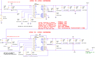

Negative Output Configuration for Review.
Part Number: TPSM63610
Hi E2E DS,
I would like to know if my configuration is correct when using the IC in negative output. I have SYNC signal to to AGND with 0 ohm resistor.
I also have SPSP signal to AGND with 261K resistor. A picture of the circuit is attached for review. I had to use two ICs so that VIN max was not violated.
Thank you for your support. If there are any issues, please relate them back to me as soon as possible.
