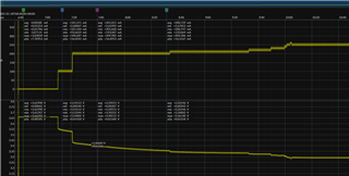

But when i turn ON the circuit, At the output of Current Limit IC(+Vlim_Out) the voltage is dropping up to 1.9V on average & average input current across R8 is 162mA initially (Attached image-2),
                Image-2
When image-2 zoom in to much deeper for as attached below image-3, i can see a high & low current peaks.
                        Image-3

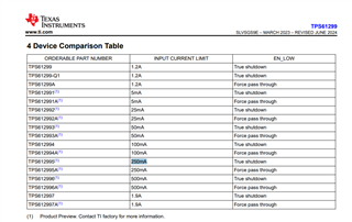

  • Hi Prasad,
    If you need lower current limit on VBAT side, please choose a boost converter with lower current limit like TPS612995.
    Travis
  • Hi Travis,
    Thanks for your suggestion, but TPS612995 part is not readily available in the market & in the TI site also.
    Do i have any alternative solution for this to limit exactly 200mA of current at input.
  • Hi Prasad,
    Please look at TPS61252. The current limit can be configured by an external resistor
    Travis

  • Hi Prasad,
    Combination of TPS2553 with TPS61023 just cannot work even in theory. The TPS61023 still sinks up to its current limit of 3.7A while TPS2553 limits the battery current to 200mA. So voltage on C4 and C5 will drop until TPS61023 shut down due to low Vin. After TPS61023 shutdown and stop sinking current, voltage on C4 and C5 will recover and repeat the above process. These are normal behavior of the devices and I don't think TPS2553 with TPS61023 will be a good solution.
